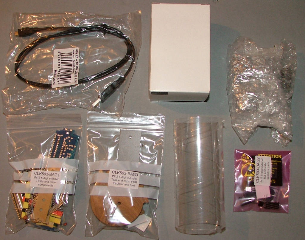

First of all, unpack and check the kit contents to make sure everything arrived intact. I've split the contents into seven separate packs as follows:
Clockwise from the top left corner -
USB A to mini B cable
USB 5 Volt power supply
Nixies - 4x IN-12 (A or B) numeric nixies and 1x IN-15A symbol tube for the centre colon.
Static sensitive component bag (bag2)
Perspex cylinder
Case parts bag - these will need sanding and if required polishing before use
Misc component bag including the PCBs (bag1) - start with this one.
